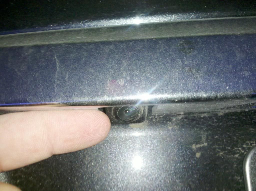

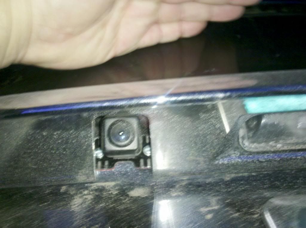

Get the connector from SVXdc and pick up a Rydeen MINy. works great and looks stock.
I bought the rear garnish from Subaru with the cut out for the stock camera. As you can see, the MINy is barely visible in the stock location.
John
edit: the car was pretty dirty when I took those pics.

Cam looks good. I'll have to think about that one. Right now I don't mind the old fashioned look behind you to back up.

Looks great! Rydeen MINy, or MINy HD?
I'm now research'n this too...

I went with the MINy. Happened to be what the local place had in stock. It comes with enough wire to get to the front of the car and plugs into the harness that SVXdc sells. Therefore, there was no cutting necessary. I cleared the power lead near the camera and grounded the ground wire on a bolt used to attach the trunk lid. It gets power from the lead coming off the HU. I am pretty happy with the picture the camera projects and it seems to work fine in the dark with the backup lights. I had mentioned in another thread that I cut a piece of flat aluminum to attach the camera to, and used Velcro to stick the aluminum to the hole through the trunk. That way, I didn't need to drill any holes and break the paint. Plus, I can remove it from the inside for adjustment if I desire to.
