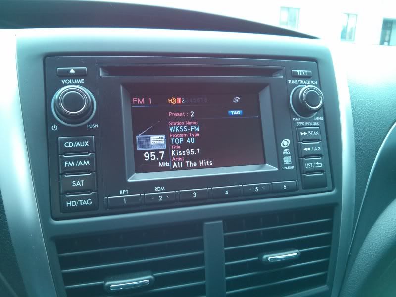

Originally Posted by luan87us View Post
^ that. Though little LCD screen and HD radio are nice features to have I don't think they worth more than $100. For $300+ you realize you can get MUCH better HU out there with much better functionality. You can even find the OEM NAV unit for around $300-$350 around here sometime.
Not if you want to keep the oem look, which I did. I'm happy with my purchase.

Just scored a 2012 Nav unit for $375. Pretty excited. Now I have to find out how to update it with different map database.
