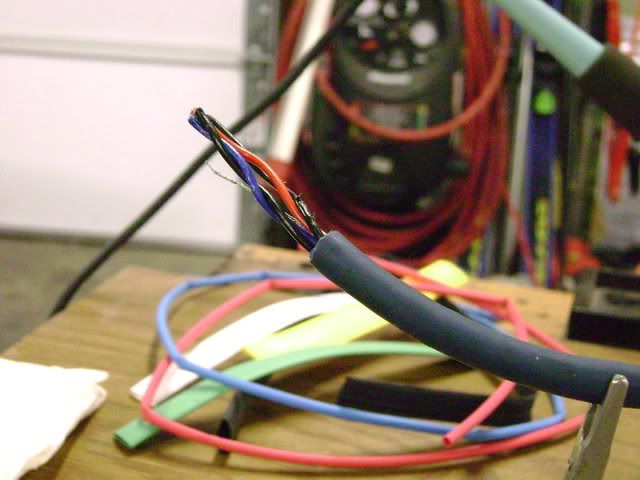

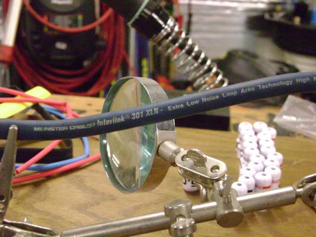

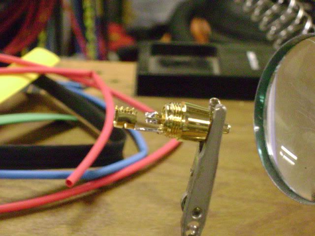

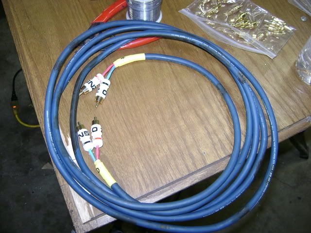

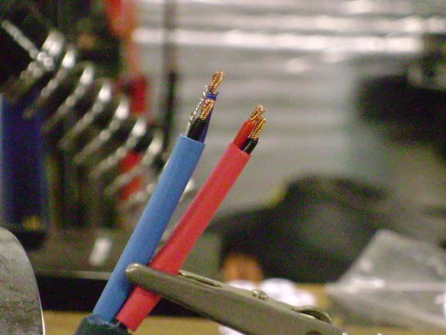

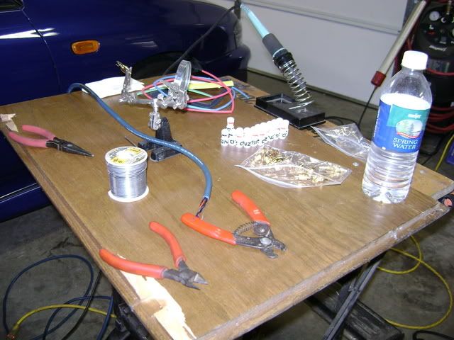

Hi all,
As I move along in my install, i'll be making more of these posts...
First off, I gotta say, a lot of people bag on Monster cable for the price.. Well, for me, I got my cable and old ends (not shown) while working a shop back in ~94' and I have been using this particular set of Monster cables ever since.. you will see some really nice build quality from this ....
The set-up... Note the Weller 33w iron.. wouldn't solder without it.. And I Ebay'ed the cable ends..
Each run is a twisted, shielded, stereo pair..
Each single conductor, is made up of 4(or 5) twised conductors, made of flat copper, wound around a fiberglass core..
Pre-tinned cable end (Streetwires ZN5.0 cable ends BTW)
All soldered up...
Complete...
Enjoy..

Dude,
On pic 6 of your post, the left RCA (the blue one). I can clearly see that the ground wire solder bead didn't even conform to the gold plating. It's just beaded and sitting on top of the gold conductor. You'll want the solder to melt better (quicker). This is most likely because your solder iron is incredible cheap. Try looking for a better solder iron. I use a Hacko with the temp control you'll get much better results. Also, ditch that solder and get No.44 solder.
pc4400 is offline   Reply With Quote

Originally Posted by pc4400 View Post
Dude,
Thanks and GOOD EYE, it's been corrected... Right after I took the pic in fact.. lol...
I'm well versed in soldering to BTW, that little "mistake" just got by me for a second, after 3hrs of making cables (about 1.5hr per) my eyes were going all..
Oh and Weller FTMFW... lol... no need for temp control as long as it's HOT HOT HOT....
