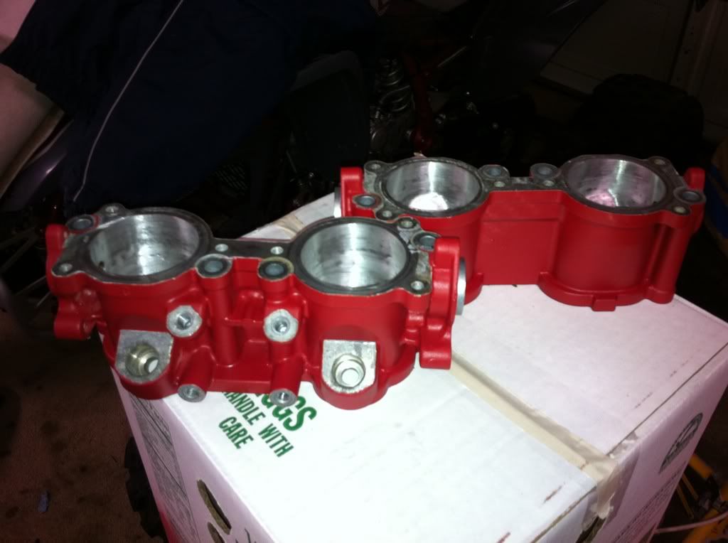

thanks to this thead, helped me do my TGV deletes. then I decided to also paint match them to my intake manifold.
bobkat is offline   Reply With Quote
Old 10-24-2011, 05:03 PM   #100
TS7XREX
Member#: 287450
Join Date: Jul 2011
Location: Gallup NM
2011 Impreza WRX
Satin White Pearl
Looks great! Installed pics?
