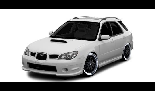

Default How Do I Get My Headlights To Look Like This (Amber Delete)
Just hate the orange part... adios.

http://forums.nasioc.com/forums/showthread.php?t=384488
More or less the same as above. remove headlights. Remove andy screws from behind the headlights. Bake 200F for 20 min. Carefully pull headlights apart. Remove amber pieces. Put headlights back together. Bake again to reseal. Use extra sealant if needed.

If it will redeem me at all, here are my plans:

what year STi is the one in the first post? I'm going to guess and 06 but it looks to small to be a 06.

Thats the new 09..sssshhh
but seriously that question is ridiculous

I've only been looking at WRXs for like, a day, and I'M lost

yes, they are 06 headlights
