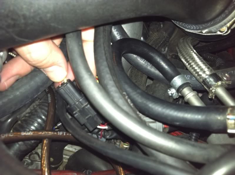

Do you have pictures of how this is wired up?

Cam can you get some pics of this wired, im gonna do this to my sti and my brothers wrx whose gauge just went out

I'll try to get some pictures today. Sorry guys.

Obligatory pic of the Full Race manifold...
It was hard to get a good picture. Just reverse the original wire colors and it will work. Unpinning and soldering the pins is a pain. If I was going to do it again I'd cut the wires from the old sensor and solder them to the new sensor. Don't forget to reverse the colors.

Alright I'll probably just cut them and resolder the wires than, thanks cam
