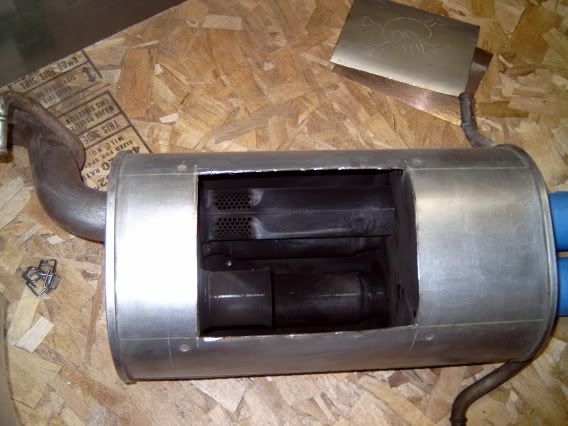

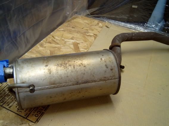

I have acquired a replacement axleback and started my WRX muffler hack project last night. sfjohnson's suggestions have been noted. I am planning on using a no-weld method to seal it up when I'm finished. I will try to work on sound clips, too, but that may be a stretch for me. I am taking pics along the way.

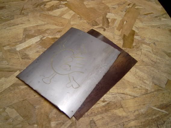

Yes, what ohnoes! said. Probably not completely like ass, but my guess is with an open-top gutted muffler about an inch-and-a-half away from that heat shield, things will get noisy. Probably even noisier than an open midpipe with the axleback removed. I actually found the open midpipe to be a hair quieter than the ride5000 mod (blah,blah - please refrain from sending me more death threats regarding that one).
I had a quick idea to do dudical26's suggestion and install the unit without sealing it up. However, it's winter here, and there would be very obvious exhaust vapor bleeding out around the muffler body. So, I will not install the unit without closing the access hole.
Today I hope to fab up a different cover. I already made one and it fits fine, but I left it in the oven just a little too long, and it has some heat scarring. Today I plan on making a more cosmetically pleasing cover, and completing the gutting process. If things go well, I will install the temporarily sealed unit tonight.

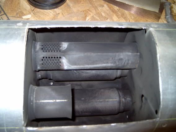

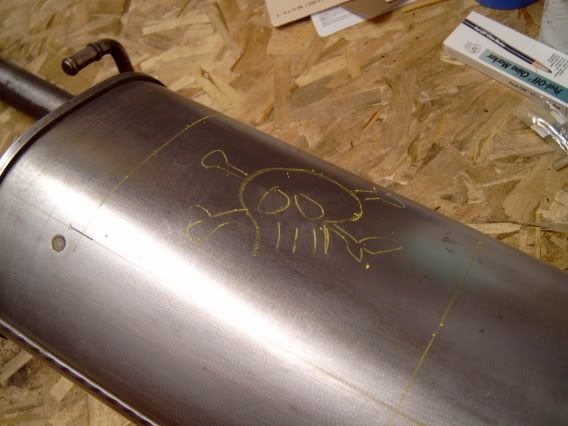

Yep, here are some teasers for you. I am working on this project right now. I have made a new cover and I am now going to begin the gutting procedure:
The muffler shell is two layers. The steel is pretty springy:
Da hole:
Ok. I'll post pics for all the steps when I'm done. But I don't think I should post it here, as I think we have outgrown the 'Member's Car Gallery.' Should I post it in the Int & Ext Mods forum, or Factory 2.0L Powertrain forum? Please advise. Thanks!

YEAH I SAW THEM DO IT ON MONSTER GARAGE ONE TIME i tried it as well your cuts are mint though i used a cutting wheel and it lookede like crap also how does it sound now

Eeesh... Good idea. That makes sense. What would you need to measure cfm? ...hand dyno or arm hair dyno?(both sense different velocities of air movement, but are not very accurate)... hee hee. Seriously, a cfm chart would be a good thing to put together.
I'm too far along to do that with mine now. I have the short velocity stack thing out and the perforated inlet pipe out. I will hang it up for tonight, as I need to ponder my tool situation for my next move.
