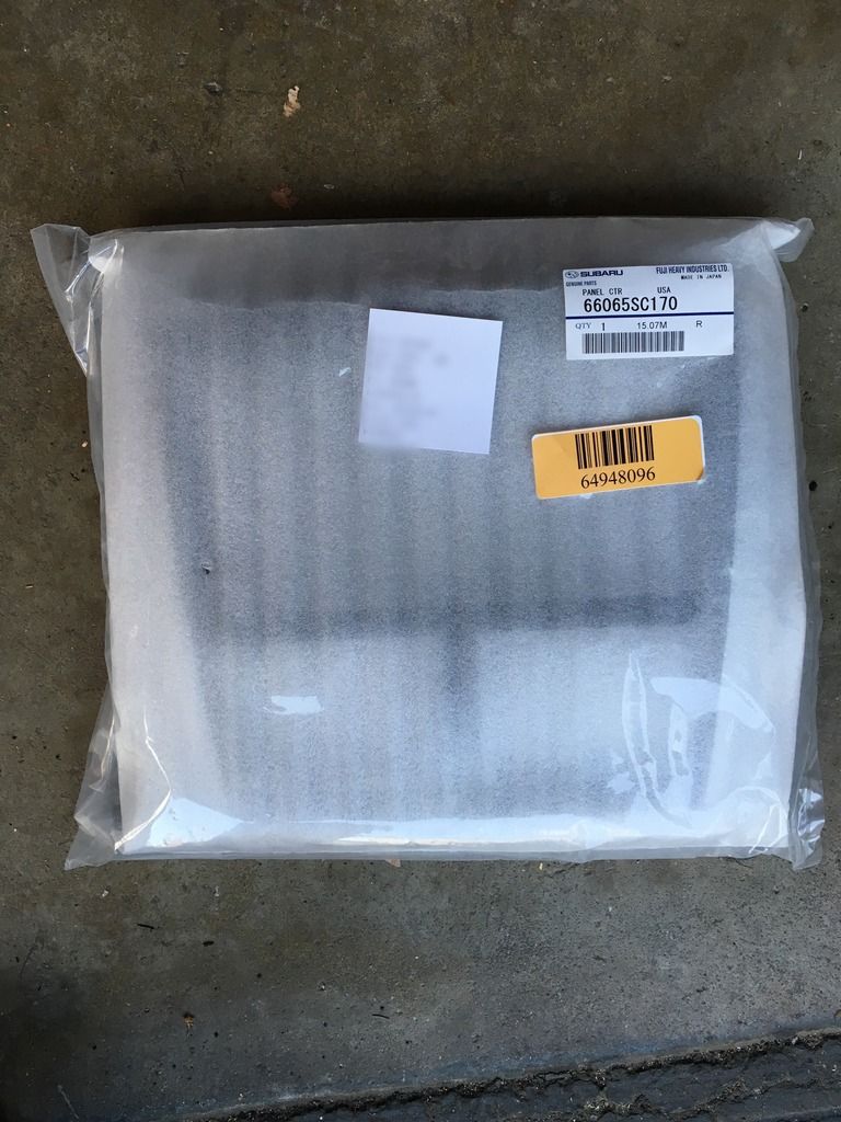

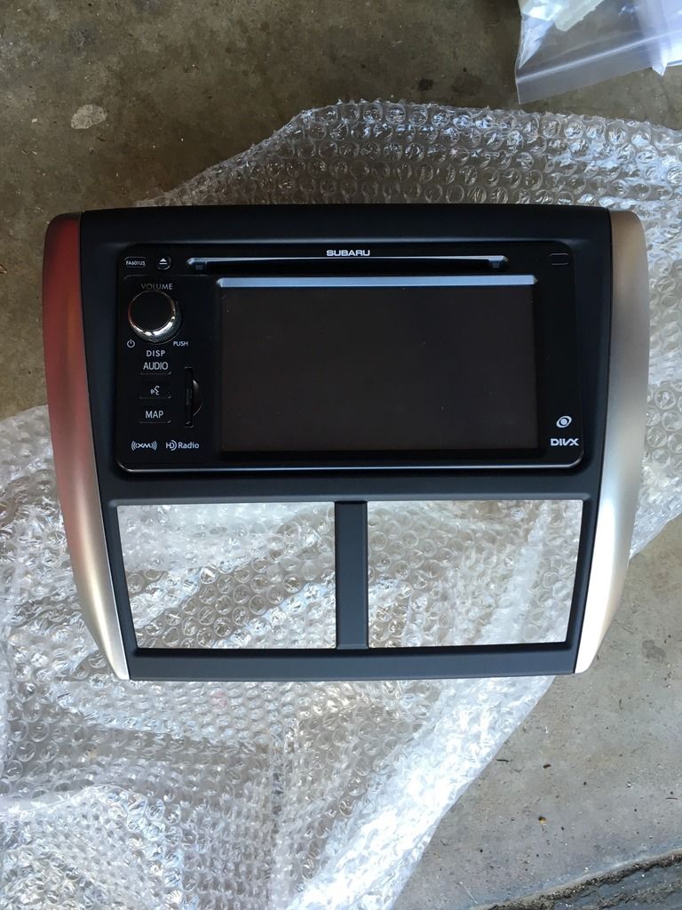

I haven't installed it yet but I got it from:
http://parts.bestbuysubaru.com/p/Sub...6065SC170.html
Powered By Jay is offline   Reply With Quote
Old 05-21-2016, 02:23 PM   #230
Powered By Jay
Member#: 442346
Join Date: Mar 2016
Location: LA, CA
2013 WRX
Just wanted to provide an update that I installed it and everything lines up perfectly in my 13' hatch with the Fujitsu ten FA601US.
