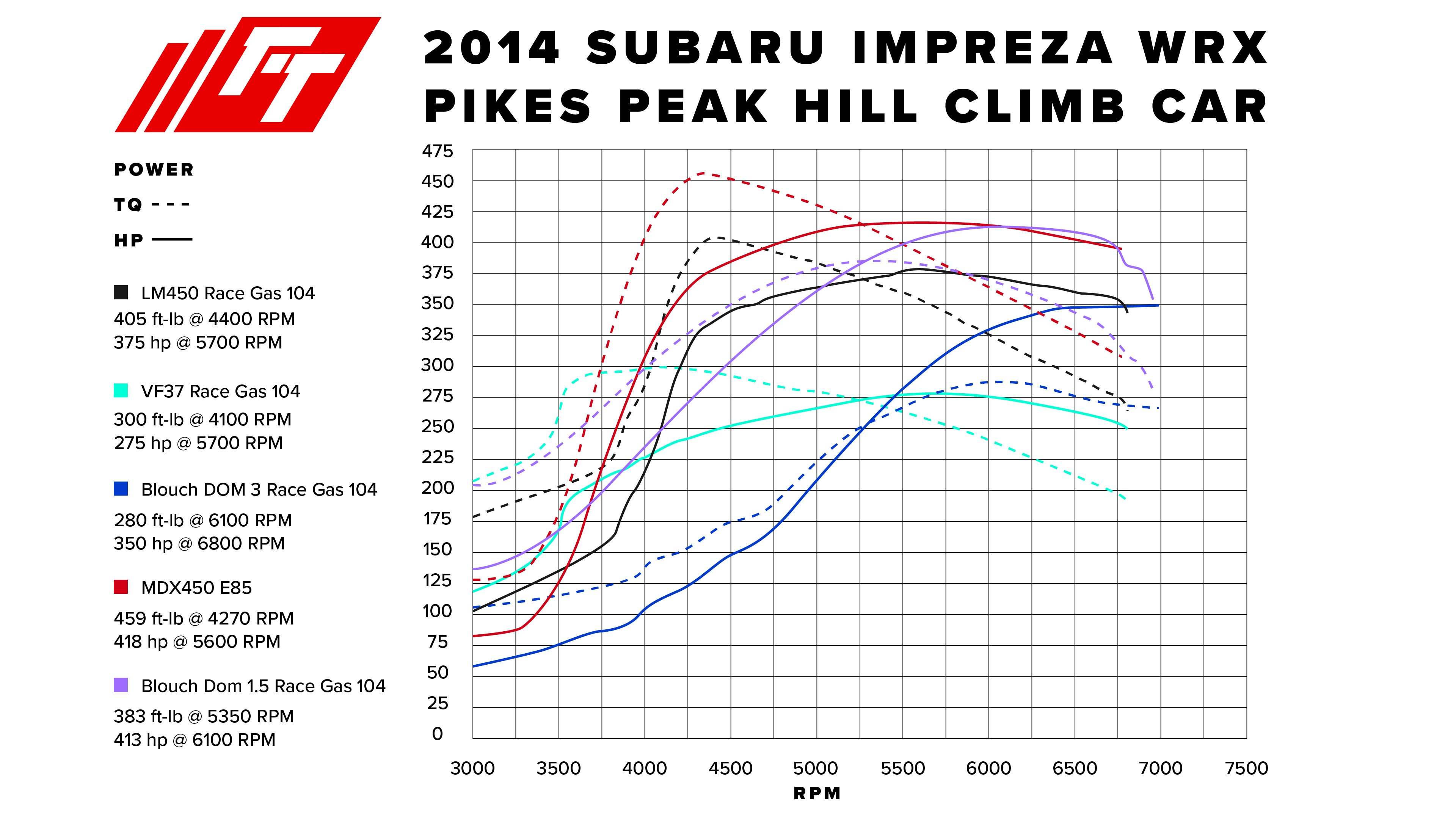

Lol. Trust me friend, making 500 WHP on a 2L does not come without some serious lag. No matter how good of a turbo you have. Twin scroll can help with spool but you will never make power like N/A.
You will still always have an S shaped torque curve.
This is in KW not HP but my point still stands. This is a G25-660 in red vs a GTX30706 in blue.
Look at dyno sheets for any 2.0L making 300+WHP and you will see the same S shaped curve. It can be mitigated, but never eliminated.
Look at the torque and HP curve on my current tune. I have a USDM EJ205 stock longblock with a Blouch 20G-XTR using a 10cm housing. The larger you go, the more this effect will be magnified.

So the twin scroll Dom turbos do not come with variable size hotsides. You get 2 x 5cm2 and that's it.
And there is a TON of nuance to single vs twin scroll...
If you want to change the hotside size you will be relegated to using single scroll. Which has much more support and upgrade options, but lacks the inherent response benefit of twin scroll.
I know you said OEM twin scroll but OP surely you can't still be on the OEM TS downpipe...?
Dancing the line of maintaining the twin scrolls performance, while also tapping into the engineering work of the aftermarket community is a tightrope walk. Twin scroll in a vacuum is a better design than single scroll, but how well or poorly the actual manifold, exhaust system, and turbo are designed and engineered plays a large role in how much better that design is, as does the specific engine configuarion.
For example, the Evo comes with a solid twin scroll manifold and everyone who makes turbos and headers for it primarily stays twin scroll because it's easy, and works well. For the WRX, most people don't have a cast iron twin scroll manifold they can slap a turbo onto to begin with, and those who do have the factory twin scroll manifold find out quickly that it is not the best flowing unit.
Most jump from twin to single scroll because of parts cost and availability, and because you can maintain the majority of the spool and response with single scroll. Not to mention are already buying a new set of headers, an up pipe, and down pipe when you are chasing performance anyway so it's not as if the majority of 400hp+ twin scroll guys are relying their factory twin scroll exhaust setup to save money.
FHI's OEM twin scroll setup is mediocre, and the housing is certainly limiting. The aftermarket stock location twin scroll options are mostly middling as well. Though RCM makes the best header for TS.
Flatirons Tuning did some good back to back testing with their Pikes Peak hill climb car and found the single scroll setups actually beat the twin scrolls in performance.
Everything except the MDX450 on this graph is twin scroll. The Dom 3 had trouble getting spooled up on the ej255 oddly enough even at 100% WGDC and after trying another Dom 3.
Also worth mentioning that ramp rate and spool is also determined by how the car is tuned. Telling your tuner to be conservative will result in a less hard hitting torque curve but will likely prolong the life of the engine.
If you are planning to go for more power, it's time to come to terms that the OEM exhaust setup has likely reached it's limit - your upgrade path from here is up to you. Single and twin scroll both have their benefits and drawbacks. You may be disappointed if you try to slap a Dom 1.5 on their and retune it as is. We don't know all of your mods as well and there is a lot to consider. If you have the money I suggest a rotated setup.
Based on you you mentioned rotated in your original post considering you are also contemplating rotating it, might as well go twin scroll correctly
Also rereading your post OP, you haven't driven a big enough EFR setup if it isn't scaring your passengers. Try a 7163... Hell my 20G 2.0L will scare the **** out of people.
Talk more with the shop who is tuning the car

Kermit, no, i am still on the OEM Twinscroll Downpipe. I am currently disasambling the engine, i am sure its the OEM one. I have a parts supplier and he said that the OEM TS Headers are pretty decent. Dont you think so?
I was mentioning rotating since its the "go to" solution at least in the states from what ive read, but i am starting to like the idea of a stock location turbo. Just because its pretty much stealth.
I am currently leaning towards the Dom 1.5 since i could slap that on the OEM TS Header and it would fit on my 3" Downpipe which is welded to fit the TS Turbo.

No the OEM catted downpipes are terrible for flow.
You really shouldn't run anything larger than stock location on an OEM catted DP. Just throwing away performance.
