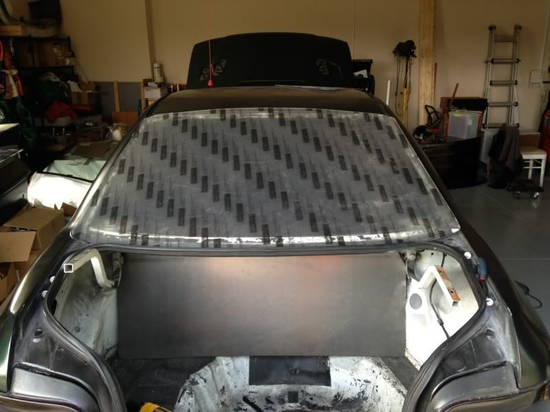

Traced it out per Jay and actually used the hydraulic shear at work. Cut the lexan like
Butter with nice clean edges. Also got the block off panels for the trunk and rear shelf cut too. Pretty productive day lol.

When you lay it on the rear windshield frame it takes the Contour nicely.

Still need to trim the top curvature out.
