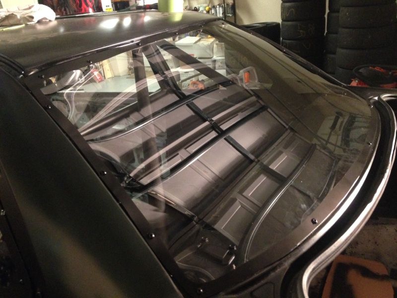

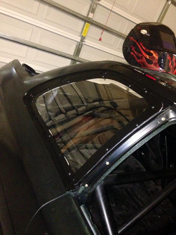

I used rivnuts and bolts to secure them. They come off pretty quick and it looks clean.
Rear window
Quarter windows

That looks great, much better trimmed than mine.

I just spray painted the outer edge, .095 thick, not worried about making a seal. But your could 3m window weld them in place, or use some sort of rubber material to make a gasket. I would rather have them removable.
