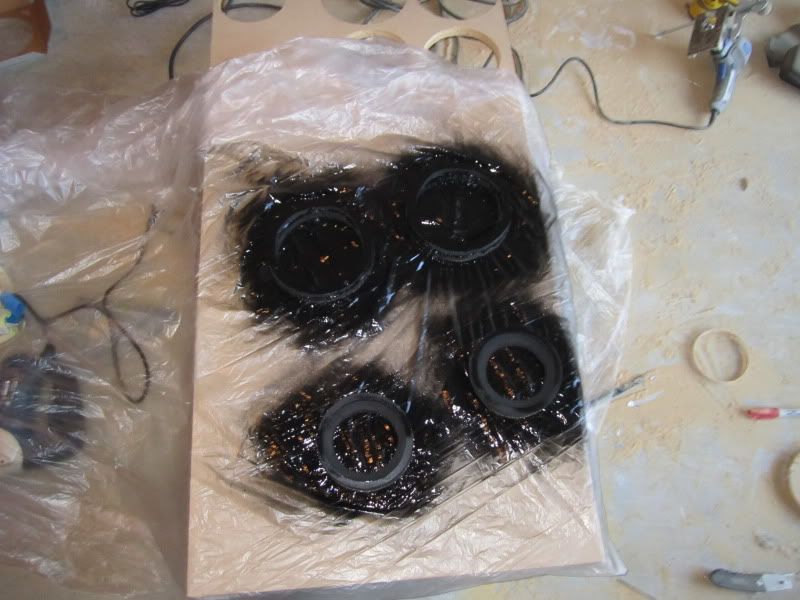

Held up the L4's to the driver side kick base.
After all that I went ahead and sealed them up with some paint.
I should have my doors together tomorrow. Still trying to figure out wth I'm going to do with my tweeters. It just doesn't sit right with me putting them in a-pillars when there's and air bag in there.

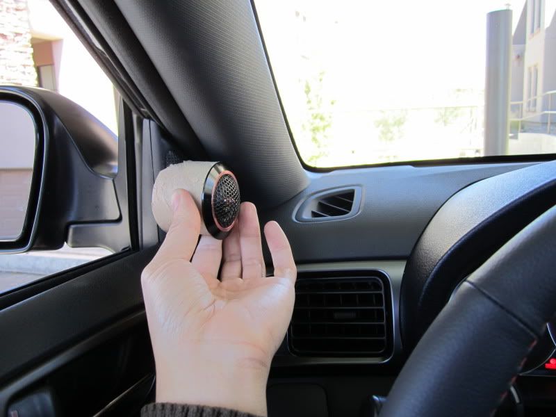

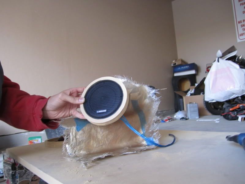

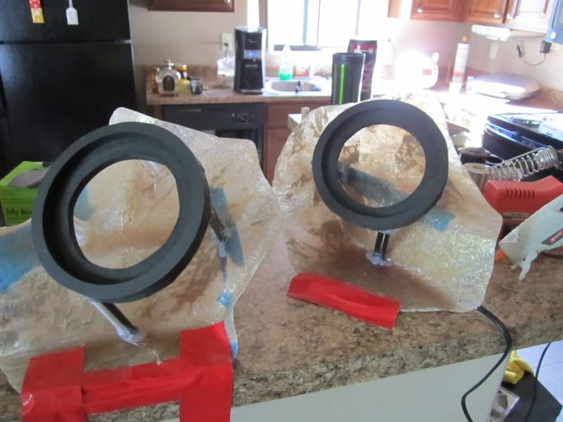

Weekly update.

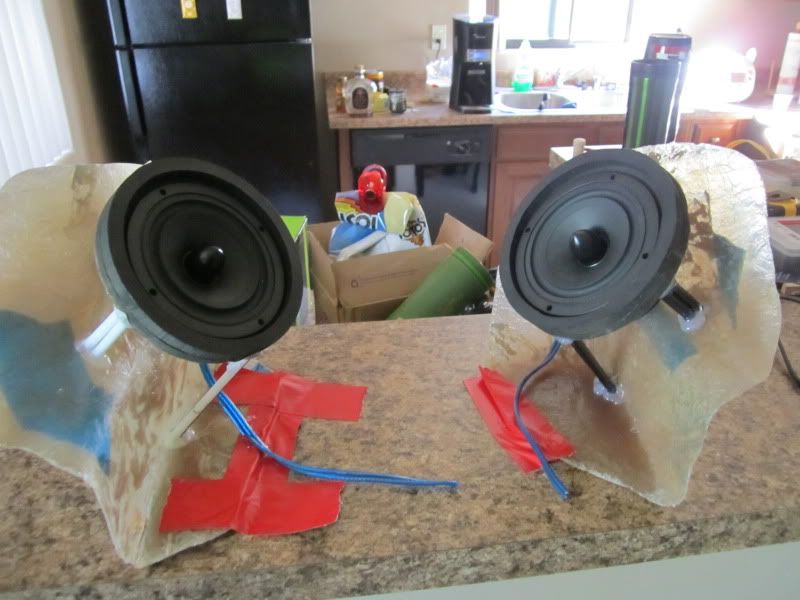

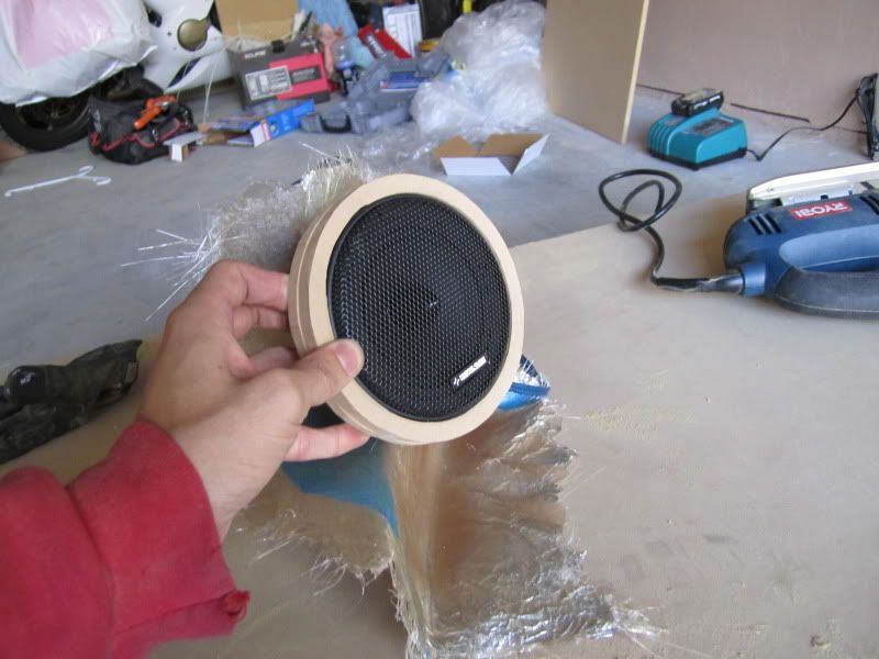

So I decided to put the tweeters in the stock sail 90 deg out of phase. Still working on the shape and forgot to take pics of where its at now but here's an idea.
Also finally started messing around with the kicks again. I forgot to get wood dowels while I was out getting stuff. So I got lazy and used plastic coat hangers. They work great! Pods are in glassing phase now. Forgot to take pics of it but here's what I got.
Next up, amp rack. Its far from done, but I got the layout finalized with it. All I really got to do with it is make it look pretty and mount it. It's not shown but I have a hinge that goes on the back side of the amp rack. I'm mounting it right underneath the rear deck in the trunk. It's not pretty now, but I should be half way decent when I'm down.
I should have the kick pods and tweeters done this week. Key word though.... "should" .. lol

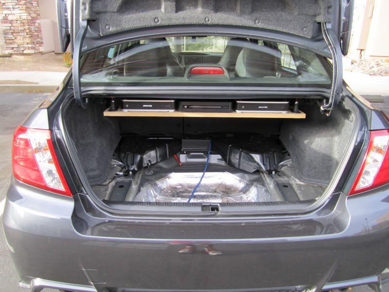

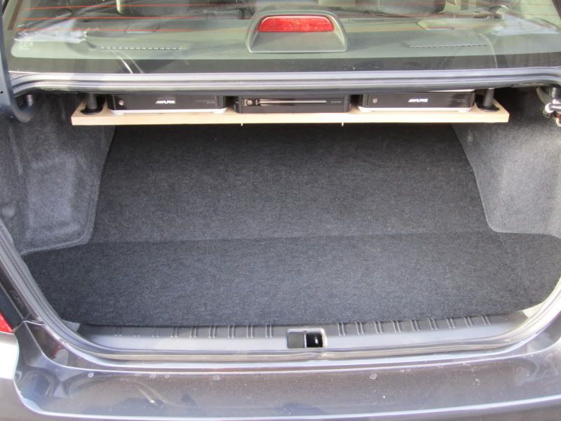

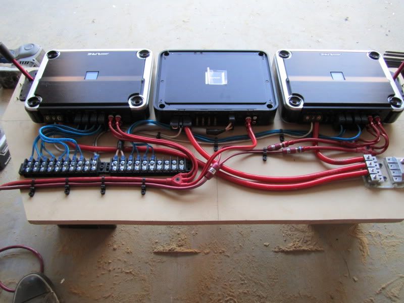

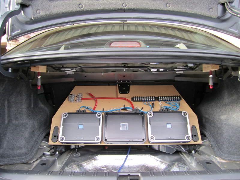

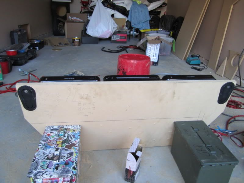

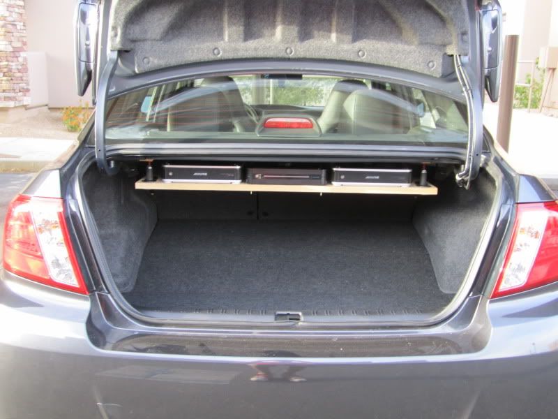

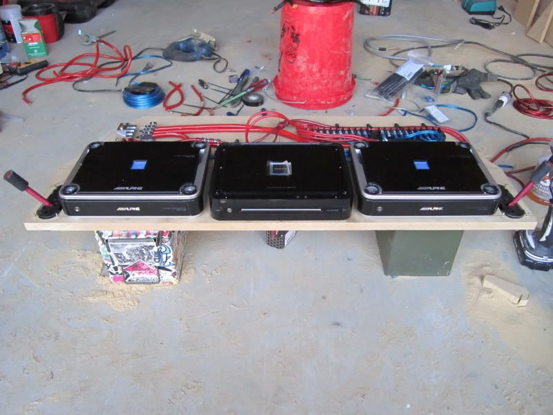

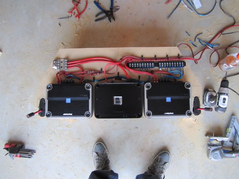

Bah... so alas... again I am slow. I think I've posted more in other peoples shiz niz than my own!
Didn't have a lot of time to do any work last weekend but I did get a couple things sorta accomplished if that makes any sense lol.

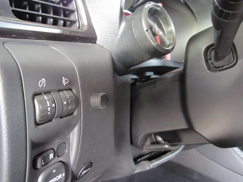

So I got the "unfinished" amp rack in. It's not all wired up or anything nor covered, but I wanted to make sure it fit and would be secure while driving around. Also before I clean it up I wanted to make sure it wasn't going to make noise by vibrating/hitting anything while hitting bumps and what not. So far so good. Looks like I'll have it covered and call it done this weekend.
This is how I want it to look + having a cover to hide the front of the amps in the end.
And this is what I'm going to try to flush out and hide lol. It looks like I can pull it off. I'm just worried about the breather hole on the back side of the subs and the overall airspace as i wont be a lot.
Lastly I got my remote bass control knob mounted. This plastic panel actually comes off ridiculously easy.
