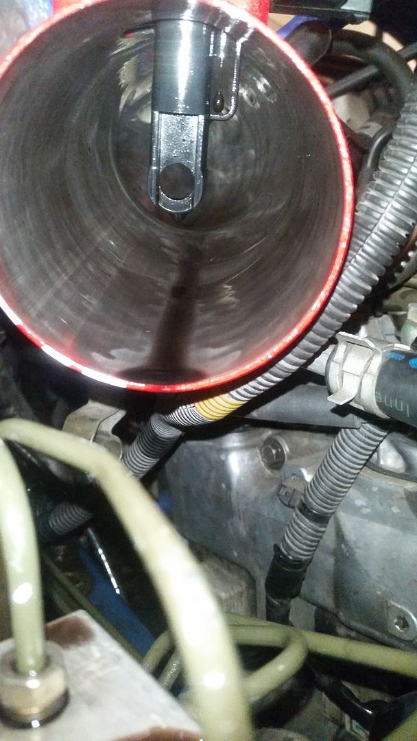

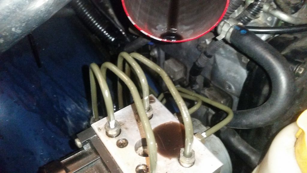

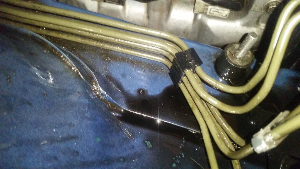

Chris I'm going to have to say there is a bigger problem at hand the car is now worse off then it was before I made the changes I will put it back to the original set up, the car freaked out and shot oil all over the place
http://i1079.photobucket.com/albums/...psiu3xggsp.jpg
http://i1079.photobucket.com/albums/...pssmsv8xlf.jpg
http://i1079.photobucket.com/albums/...psayojmpom.jpg
the car was clean and washed after i rerouted the lines and this is after 6 min of run time and only 1.2 miles

Cissac where is the oil coming from? I cannot tell by the pictures. Did you apply the RTV sealant to the bottom of the AOS. The oil ring by it self will not seal it needs RTV.
Per there instructions
Read through entire installation before starting this project. There is a decent amount of planning needed for hose routing, and it is important to understand the full installation before beginning installation of the AOS. Mainly to orient bottom of AOS before sealing it with RTV.

Sorry to hear about the install. Do you have any pictures of how the lines were set up? The PERRIN AOS won't cause oil to come out of the intake, unless something wasn't installed properly. You can email me pictures to [email protected].

I think the turbo is getting too much oil at the moment I am running a -4 steel line with a .035 restriction should i try using another oil restrictor?
