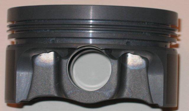

This build was a test of the basics of the H6, so drop in pistons were the answer we were looking for. With recent interest in Supertech products, we sent them an OEM piston set to build our first set of custom pistons. Because this was a SEMA car, Willy at Supertech was very excited about doing the H6 build as it was nothing he had seen before. This was a huge help in getting our pistons right away and getting the ball rolling with the build.

Time to drop the pistons in! Just like they should, they had the right clearance we speced out, and they fit great. During the installation, we came across another thing that differs from the 4 cylinder. The wrist pin installation is just a little trickier. In order to get to that center cylinder and its wrist pin took some patience, and custom tool. But once we got the hang of it, no big deal. The wrist pins fit the pistons and rods perfect, so it was time for the next step.

As some of you might remember from the other ***8216;Part 1 H6' thread, my first motor suffered a pretty extreme failure related to the stock rods. The stock H6 rods are very thin, so while I was only running 12psi, that was still over 400whp or over twice the stock power. Since Jeff's block was fully sleeved, I decided to try something more in the middle of the two original setups. I bought a new H6 case and crank, and put it together with the same rods and bearings as JeffPs setup.
For the pistons, I have a new choice as we spec'ed a custom set of H6 pistons from Mahle as well as Supertec. Take a look:
Stock H6 Piston
Stock H6 Piston
Stock H6 Piston
Mahle 8:1 CR H6 Piston
SuperTec 8:1 CR H6 Piston
The Specs on the pistons:

Also, the wrist pins are a bit different:
Stock is 90 grams , Supertecs are 110 grams, and Mahles are 99 grams.
