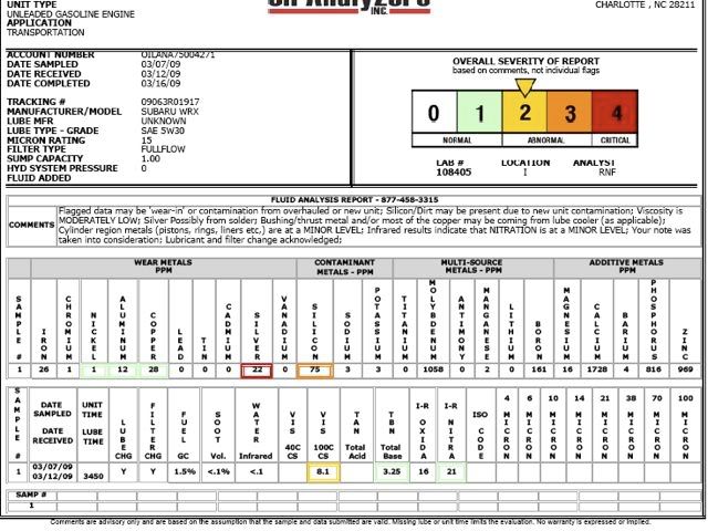

didn't realize Michael's UOA was from a different company- little different layout, but the #'s are all there :
Critical amounts of silver eh?

26525 - just doin' a bit of chain jerkin'. I remember the smell of castor oil at the track back in the days when they were racing the 'vintage' racers the first time.
Ha, sorry hope I didn't sound brash. After taking a closer look at your UOA, I don't see anything "abnormal", except for Silver. I've never seen such elevated Ag amount. Even after comparing another WRX UOA with much higher wear than yours, Ag was still only 1ppm. I'm starting to think Ag is from outside contamination (during sampling or lab error). Other than Ag, appears the oil held up quite wel. I wish they would include average values from other EJ motors that particular lab has tested for baseline comparison because lab to lab variation DOES exist. This spreadsheet posted up at another forum can give you an idea of "expected" numbers after break-in:
http://spreadsheets.google.com/ccc?k...5exEIcwPtRPlBA
Just to compare you report with mine from Blackstone:
Mine (1,000mi), Yours (3,450mi)
Al: 9, 12
Fe: 18, 26
Cu: 16, 28
Sn: 1, 0
Ni: 0, 1
Pb: 0, 0
Ag: 0, 22
Cr: 0, 1
Here is another recent UOA for an STi during break in which has raised some concern for bearing wear with much higher Cu than ours: http://www.bobistheoilguy.com/forums...343150&fpart=1
It wouldn't hurt to ask the lab you used to re-measure the sample because you are not confident in the accuracy of their reading for Ag. You could even mention that Blackstone re-samples if the customer has any doubts about their first results
