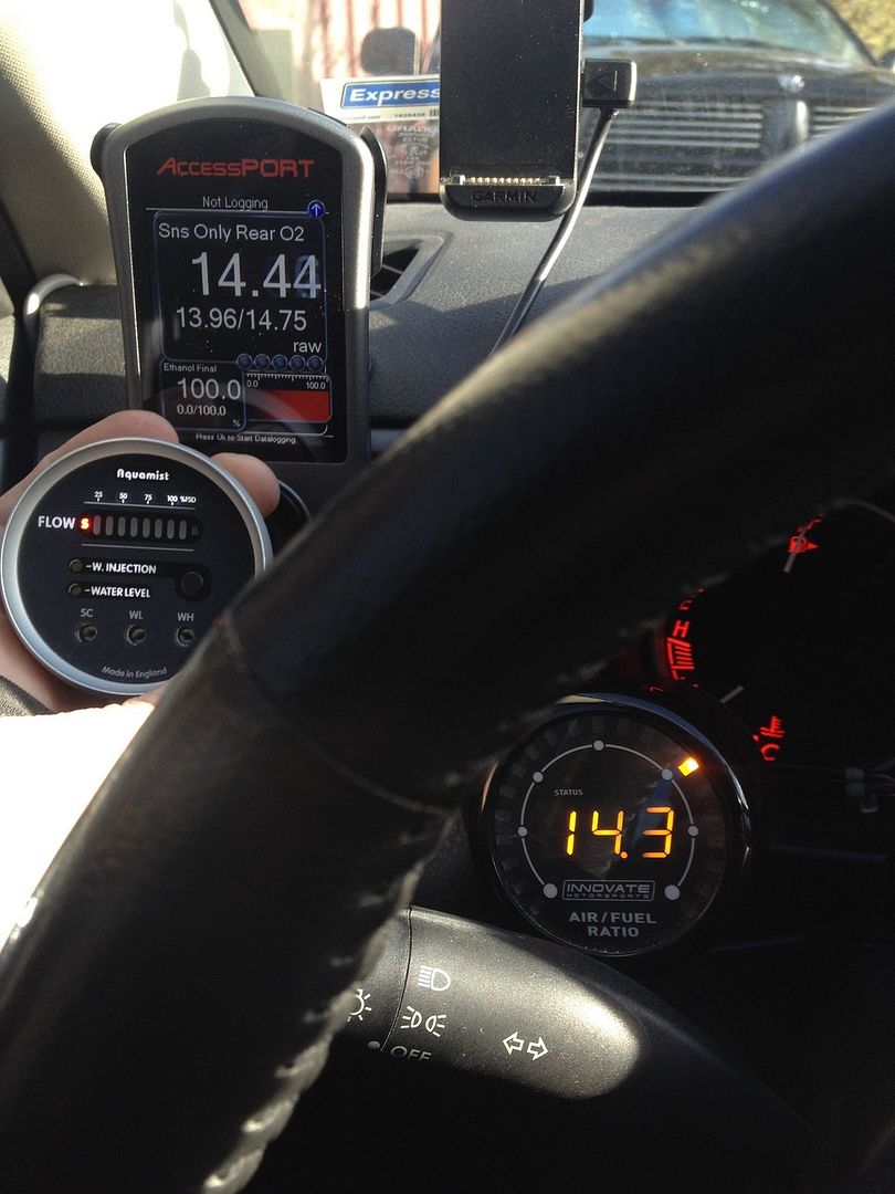

Default UPDATE: now running cobb flex fuel software & map switching for water injection
NOT using e85, but wanting to use multiple maps...
Without being able to see the flex fuel tables until cobb releases it in acesstuner.
Has anyone thats used/tuned the flex fuel know if it would be possible to hook into the tgv input the flex fuel program uses, and use that to trigger map switching?
Basically, I'm wondering if I can use the flex fuel software/input, and wire in the AUX output of my aquamist controller, to switch maps?
That way I can have my regular 91pump map/boost/etc, and switch to another map/boost/etc when I have the water injection switched on.

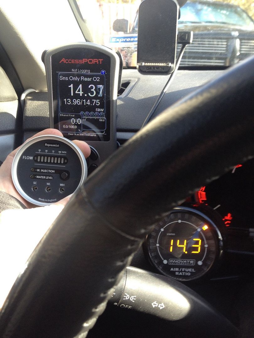

Old 03-11-2016, 10:18 AM   #2
point78
Member#: 344329
Join Date: Jan 2013
Location: Summit County
2008 Wrx, 6mt
Aquamist off, running pump91 maps, Wideband thru AP, new cobb CCF
Aquamist on, "100% ethanol" aka meth maps, wideband, new cobb CCF
