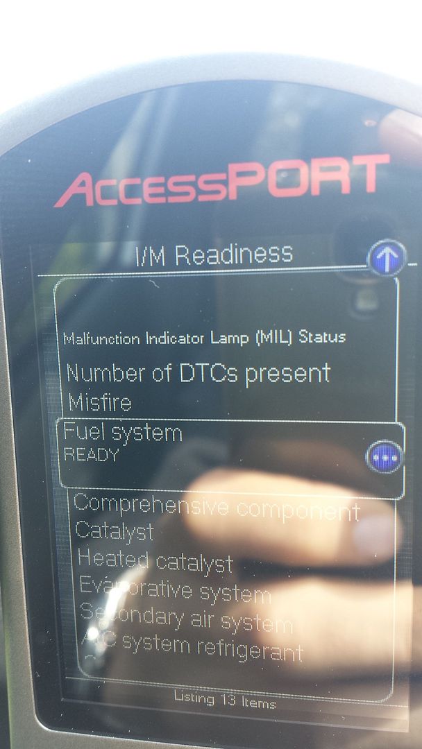

Mine shows ready. I'm tuned with catted tbe, 3 port, tgv/egr deletes.

April 1st. Tuned by Mikey Botti at EFI Logics. Yeah, I checked a few days ago because I saw a post of yours in another thread.
