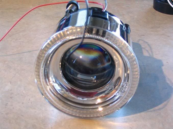

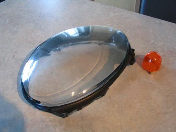

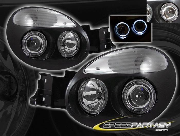

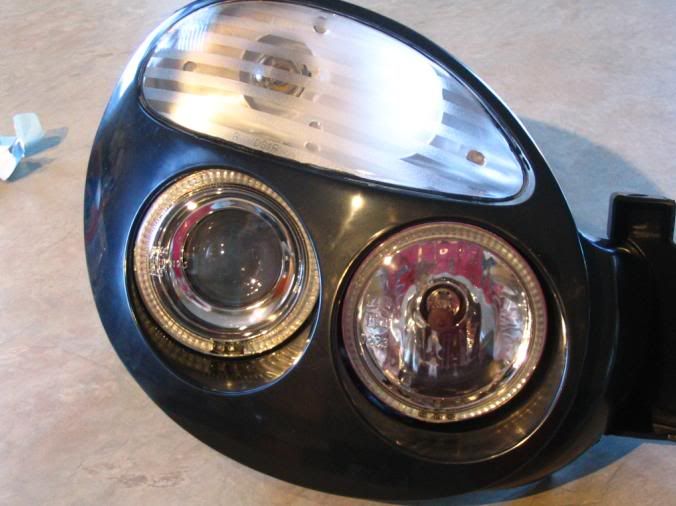

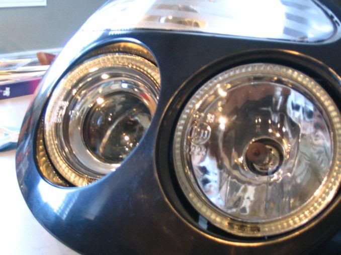

Well I've started to acumulate all the parts that I need for my custom headlight project that I am about to embark on. I'm going to make sure that I update this thread with the progress that I make so if anyone else feels adventurous they can join in the fun on their own.
So far I have the following:
- Spare Bugeye headlight lense cover
- Spare Bugeye amber headlight turn signal cover
- Cheap $199 halo projector headlights from ebay..

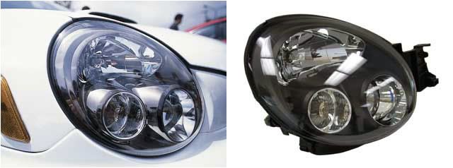

Generally the final project will be a combination of these different styles:
As you can see these ebay lights will allow for the stock Bugeye lenses to fit over top of them to give the STi look.. however the the top area is for the signal light area much like the Koji/painted stock headlight mod.
So basically I am going to modify the 2 projector cylinders to seem more like the STi headlights instead of the WRC type of headlight.. so you will see the cylinder tubes for the projectors much like the STi lights.
As you can see, the cylinders are there on the ebay lights, it is just a matter of exposing them and molding them with the rest of the headlight to give it more of a 3D interior like the STi light:
I will be removing the IMO cheesy white/clear cover on the ebay lights, mold over the holes left by them and glueing the stock Bugeye amber signal cover over the turn signal. Also modifying that area a bit more to flow with the molding being done on the projectors.
At the end I think I will paint them a gunmetal with metalic fleck so they look black from a distance, but gunmetal up close. Also paint the inside of the projector cylinders with chrome paint and hook up the halo's to the parking lights.
It should be an interesting project carving up these lights...
To be continued....
Tim

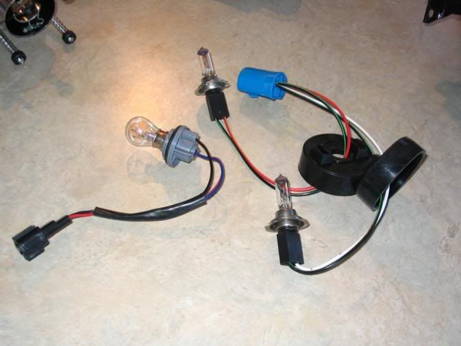

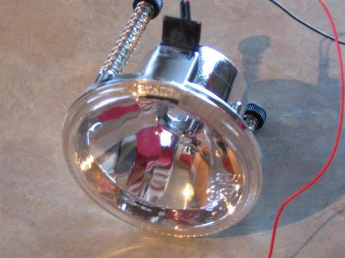

Well I now have all the parts that I need and I have started the process.. I have posted up some pics of the headlight unit and its parts plus some of the first cuts so you can kind of get the idea of where I am heading with it.

If you aren't going to replace the lighting units themselves, you will end up with a set of nice-looking lights with horrible lighting performance. The beam pattern of those projectors has been reported to be awful, and the reflectors are just as bad.
IMO this is only worth doing if you retrofit some quality lighting modules. And whatever you do, please do not put HIDs in those things, it will only make the situation far worse.

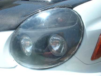

make sure you do a better job sealing it then this guy
otherwise, your efforts wont be worth it.
and ditto on the changing projectors to HID based with real HIDs.

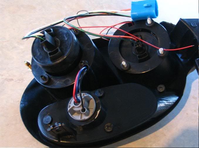

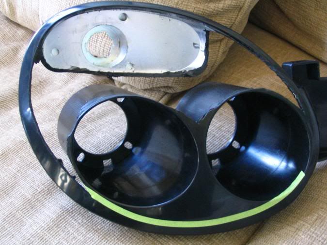

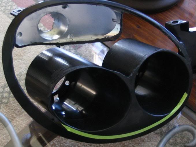

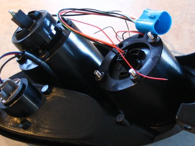

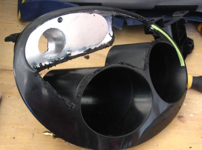

Did a little bit more cutting this weekend... It is still freaking cold outside so the fingers can only take so much.
I have to do some more trimming of the upper area around the turn signal and then I should be able to fiberglass in the top. Need to do that first so that I have the support to cut out the area below the projectors marked in the green tape.
I'll be trimming down the cylinder on the outside that holds the projector to give a more staggered look like the JDM headlights as well. Just need that fiberglass work first to hold them in place.
